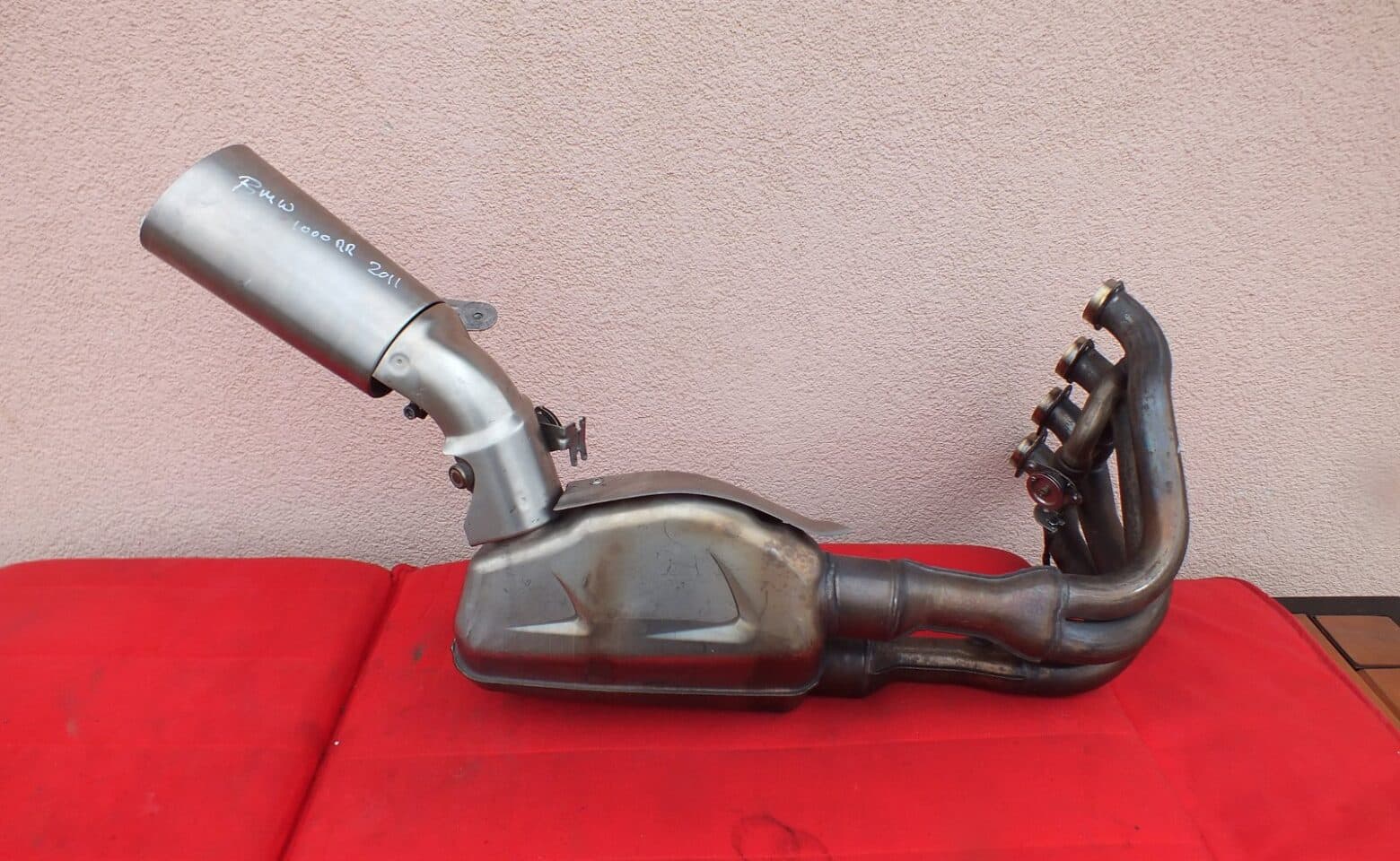

Katalizator Yamaha R1 RN32.

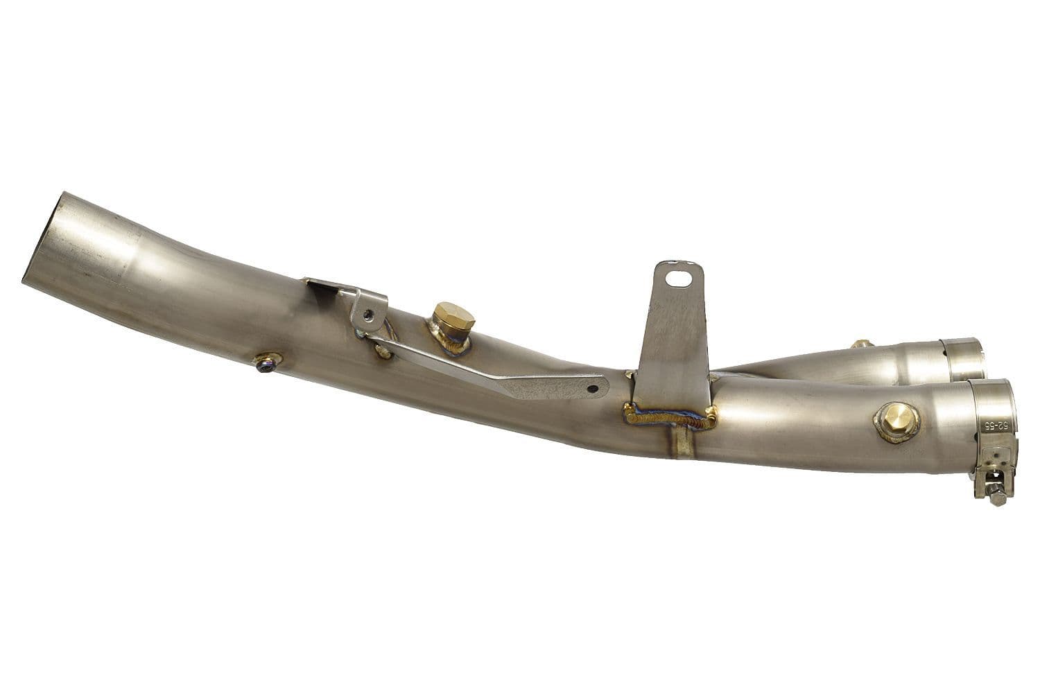

Dekat do Yamahy R1.
